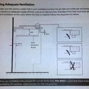

    That sounds feasible as the oven is not going to over heat. I am happy to go along with that and fit as it should be thank you. just the second part of my question re the wiring and fuse to sort now

    Ooophs 65 mm deffo a typo I take it you have fitted the same model did you have any issues when fittting ?

    It was the ventilation I was concerned about as I didnt want the hob overheating and becoming faulty and invalidating any warranty cos wrongly fitted

    The 65cm is the distance from the hob to the extractor or cupboard above it how does the heat resistant board fit into the equation

    brilliant thanks it's the bottom diagram that is causing the issue

    Page 16 in mine ty

    No to get the 5cm gap between the bottom of the hob and the top of the oven body I would have to lower the oven so it would be situated within the plinth area and be out of line with the tops and bottoms of the kitchen units

    does this diagram help shed any light [/img]

    Yep thats what through me I thought at first it was a typo, it says 5mm gap between the worktop and front of the unit and 5cm from the underside of the hob to the top of whatever is below it....the instructions are not very clear and is in drawing form. would it help if I posted the drawing...

    Hi I am new here and have just bought a Logik lchobtc10 hob and want to fit a double oven underneath but the installation instructions state a 5cm gap under the hob which means the oven will not fit in a standard carcass....Currys are useless and very unhelpful I see hobs displayed with ovens...
