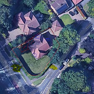

    The letterbox is on the gate as there is no door facing that way, but that is the entrance to the house, just to be 100% clear the attached image has an X where the gate is and as you can see the blue circles are where the doors areGate by shaunc50 posted 17 Sep 2019 at 9:58 AM

    The letterbox is facing what I have marked as number 1

    If you look at the image there are 3 doors none of which point in the direction of the number 1 on there (which is the main street postcode) so not sure how the above would work? My worry is that due to both being highways I cannot come forward of either road from the house without planning...

    So if I left it off the side would it still need planning permission? And which one 1 or 2 is the principal elevation?

    I want to add an extension but my property sits on a corner, the extension would be forward of the second facing which is a highway and this is due to it being a corner property. The actual postcode and entrance are from what I have marked as number (1) I am just wondering if this would be...
