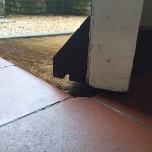

  7. S
    Gap under front door
    thank you. I assume i attach that brush on the inside edge of the door? Is there something that be slid into the groove that you can see that would protrude down another 5mm or so to give a better seal with the stone floor? Thanks in advance for your advice.
    My front door has a gap which i assume was for some type of brush/insulation flap. There is currently around a 5mm gap at the bottom of my door when i close it. Can any kind person link me to a product i can slide in there to stop the cold air blowing into my house :) thank you IMG_5365 by...

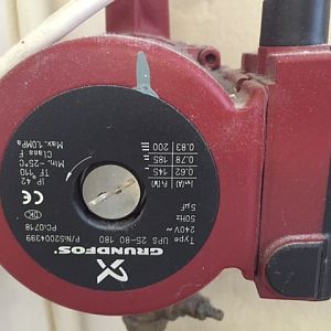

    New House - Old Ideal Mexico boiler - advice please
    Thanks everyone. Im still unsure how this system works - see photos below for more details. ....This is the pump/valve next to the boiler This is the control on the boiler Pump/valve in first floor cupboard cylinder in loft with a ?white cylinder attached on top of it?!? controls attached to...
    Dear All, Am new to this forum so I am grateful for your advice. I have just bought a house (3 bedroom detached) which has an Ideal Mexico boiler in the celler area. There is a programmer attached to the wall nearby and a broken thermostat controller in the hallway. There appears to be a pump...
