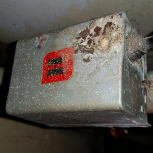

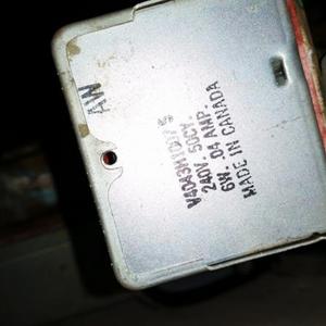

  4. Untitled

    Old Baxi Bermuda 401 Hot water No CH
    cheers guys the valves are both 2 way only. I'm guess 1 for the hot water 1 for the central heating. I turned on the water last night and manually pushed the central heating one open which was the one not already open. and locked it open. all the radiators got hot!! But obviously when the...

  7. S
    ok thanks will try sliding the switch and latching it tonight see if it heats the rads as well. Does the boiler not fire up? if the valve was faulty then? that the bit I don't get? I thought it would fire up but not heat the rads? I will have to get him round. hes been laid up recently...
  8. S
    thanks for the reply there are 2 separate silver boxes ( I presume are valves) on different pipes with auto manual on and a little pip you can slide across. the gas fire in front of the boiler was disconnected (shut off) when we got the house 3 years ago. a gas plumber (friend) said they...
