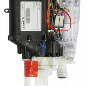

    Electric Shower - small spark from connectors
    no i'm not using the shower with the case off, testing it with the hose off the hook in the bath facing away from the shower nowhere near it. as rjm2k said to test it before i seal it and start using it. But thanks for your kind consideration for my health and well-being. Thanks Bernard, i...
    Thanks Guys. I was told by someone else its probably not something to worry about. ill try tightening up the connections with some pliers and see how that goes. It is literally when turned on and off not continuous so i thought it might just be as its drawing a lot of power. ban-all-sheds...
    HI All, I did do a search for this but you can imagine how many results were returned for electric shower and spark. I have installed a new shower and i noticed when turning the shower on and off that there was a small spark coming from the connectors. this is away from the wiring and i...

    Circled is the area where a small spark comes from. its behind the 2 white connectors.
