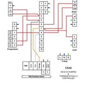

    Pump/boiler running continuously...
    That is PROPER helpful! I am pretty sure I have done exactly that test for the Programmer - pretty sure it's shot on the HW side (both HW ON and HW OFF are constantly live I think!). As for the room stat I will test that as prescribed as I am not sure I have done that without the MPV...

  5. S
    Here's how I have wired in the system currently. Any thoughts?
  6. S
    I will wire it all in as the remaha diagram tonight (involves some drilling through the walls to run the extra wires and get the permanent feed, which I think is why the fitter couldn't be bothered...) Thing is though I don't see why that helps fix the fact that the switched live is not...
  7. S
    D_Hailsham - thanks for the link. I have the book of that and it's certainly not how it was wired in by the guy who fitted it. In fact I know that the links in X2 are still there and the pump and boiler L on X6 is being fed from the switched live in Junction 8 on the remaha diagram, rather...
  8. S
    right. Here's the long and the short after the overnight investigations. It was indeed the hot water side of things that was staying live BUT - the NEW programmer NEVER turns off the hot water (HW ON is always 240V and HW OFF is always dead - no matter what the programmer says it's doing)...
  9. S
    Thanks for all your comments. I took the orange wire out of the system this morning and all stayed live so that only leaves the heating stat feed. Obviously I will re-confirm this when I get home but assuming the heating stat is where the permanent live is coming from I wonder if you have any...
  10. S
    Thanks for the quick responses. Pump and boiler are both connected to and powered up by the control system (using the switched live to power both - fed out from junction 7 on the diagram that is also connected to the MPV orange wire and the call from the HTS3). Both are working correctly...
