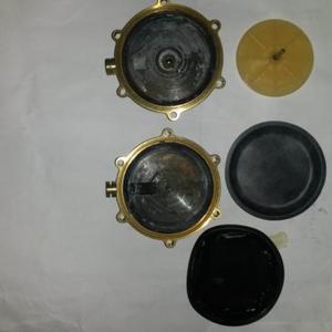

    Jaguar 28KW Combi Boiler, how to change diaphragm?
    Here is a picture of a dismantled Jaguar diverter valve showing the badly disintegrated black rubber diaphragm compared with the new one next to it. The part number of this 78mm diameter diaphragm is:- BIASI DIVERTER VALVE Diaphragm BI1011102 Cost is about £3.50 on ebay inc p&p.
