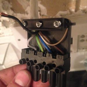

    You flipping beauty!!! That's it!!! Operator error- I've never been happier to have my mistakes highlighted!!! Thank you!

    Yes! I've already replaced on PCB on this boiler. The electrics were fine before I stripped it down this time. Getting 230v at the plug just before it goes into the PCB.

    When the socket is connected to the plug I get 230v between N & L3 at the socket side of things, so the connection is good. The black wire gives 50v btw...

    I'll get a better photo. The black socket (leading to PCB) has all of it's wires in place. The plug leading from the programmer has from right to left: L3 Brown, N Blue, Earth yellow/green L2 Grey L1 empty The socket it plugs into has: L3 Brown + Black, N Blue, Earth...

    Hi folks, I have a an ideal isar that I had to strip to repair a water leak on (iso valve) and on re-assembly, the control panel is dead. It is operated by a Plumb Center 5/2 day timer, that is switching on. On closer inspection, the feed from the timer goes into a black connector (photo...
