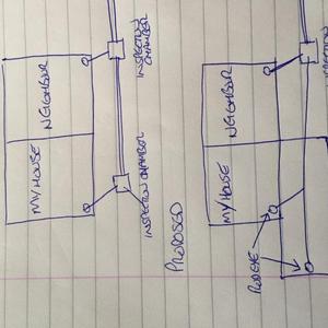

    Extension over inspection cover
    If I go with plan A, which is rod eyes, I will remove the existing chamber, I see no value in leaving it there. Plan B is install a new chamber in the new utility, removed the existing chamber. Plan C is to move the chamber outside but I would have to put a bend in the ground. In any...
    Image above shows drain as it is and drains after extension. It would definitely be better to have the inspection chamber external. I know about bridging within the below DPC brickwork with lintels and thats fine. My only issue with moving it outside is I thought there had to be a...
    Hi all I am building a single storey extension and it will go over the existing inspection chamber. My house is end of the line so I am the only house connected to this chamber. Do I need to retain this or can simply fit rod eyes in the kitchen and new bathroom? Thanks for any advice...
