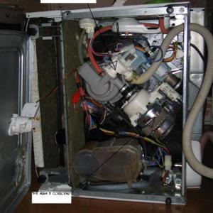

    Hotpoint Dishwasher FDW60
    Hi again! This picture isnt my dishwasher but this is exactly how it looks. The impellor was moving ok when I took the small pump off. You mention putting a screw driver into a slot is that on the other pump and at which end, there is a metal coil at the bottom end of it. Thanks alot...
    Thanks for your reply. I have taken the pump apart and checked the waste pipe both of which are clear. What I think is the circulation pump (underneath and slightly to the right of the pump) is very corroded and has leaked onto the base plate. As the machine is stopping when the spray arms...
    Hi hoping someone can help For a couple of days my dishwasher sounded like a coffee perculator, then stopped working and Eco and Fast lights started flashing. I understand from ringing Hotpoint this is a Blockage, pump connections or module? It drains the water and starts the cycle then...
