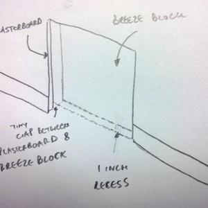

    Fitting an electric fire
    Yes, the inner wall is not damp so thats good!! Unfortunately there was no spacer otherwise everything would have been much easier. I was just worried about the hole created and the effect on ventilation. I will call the manufacturer just to be on the safe side. Forgot to mention the fire...
  5. S
    Hi, I have a marble fireplace that fixes against the wall, with a back plate which has a hole for the electric fire. However, the electric fire projects behind the fireplace by about 2 inches which means I have to cut a 2 inch recess into the wall to alow the fire to fit flush against back...
