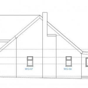

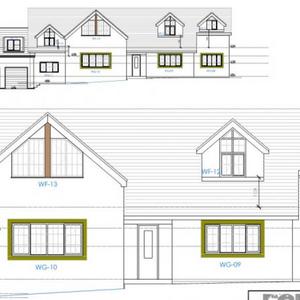

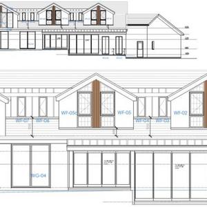

    Has my Architect been Negligent?
    One further technical drawing brought to our attention by SE, potential new contractors etc.... Proposed side elevation tech drawing does NOT show front & rear dormers nor new front porch, which is different from the pretty plan drawings. * What approach do you think we should take...

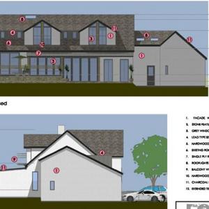

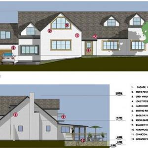

    Garage door is not the problem, that was our amendment. We are talking Fenestration issues - 1) If you follow the lines of the garage on the coloured Planning drawings as opposed to the technical drawings you will see they differ. 2) Dormer 2nd in from right is larger in the tech drawings as...
    I have now attached some Architect drawings... see if any of you can spot the differences! At no time did we as clients give consent to the Architect to make material changes that could/will jeopardise the build and be in breach of planning based on the approved drawings. The colour drawings...
