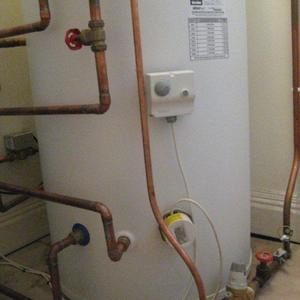

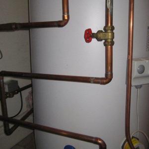

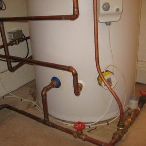

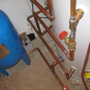

    Just thought I would update everyone having spoken to Telford. They claim this problem can occur on big systems and advised me to put a balancing valve between the flow and return. I did this and this has resolved the problem. I only opened the gate valve slightly when the vibrations started and...

    Regarding mickyg comment. I am not a plumber so are you referring to the gate valve in the picture? Sorry not sure what you mean by " between the safety group and the cylinder inlet." If so can you please explain the problems/issues with having a gate valve there. Is it a safety issue...

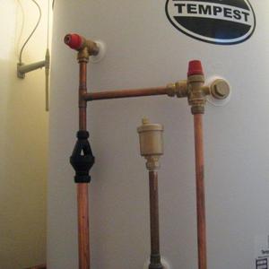

    Telford Tempest unvented cylinder resonance/vibration noise
    I have recently had a new Telford Tempest Unvented cylinder installed by my plumber and am now suffering noisy vibrations/resonation that sound like a whirling helicopter as soon as the hot water is switched on. This only stops when the central heating is switched on. The buzzing noise seems to...
