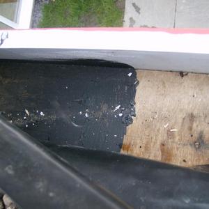

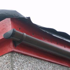

    Edit: having just re-read your last post, to sum up, trying to sort this by drilling holes in bits of wood for drainage is a right bodge and you'll end up with the same problems you have now. Fix the UPVC gutter behind the fascia, dress the membrane into it and drain it with a downpipe through...

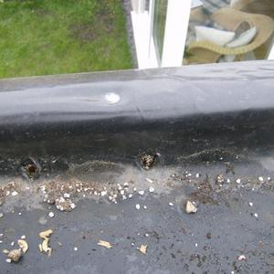

    [I would try and get the gutter inboard of the fascia with the 'water membrane' dressed directly into it, ] I think this is the easiest remedy trying to sort the mess we are in, combined with drilling tight holes for the pipes through the facia. The main question is if I cut the membrane...

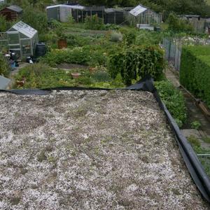

    The fleece keeps the soil/substrate in place. It is above the membrane layer. Would some sort of coupling do the job? ie getting water through the membrane and dropping in the gutter. If I dropped the front what would keep the soil in place? My brother in law did the job, it was his first...

    Hi, I have had a green roof put on my shed. There is a water membrane with 30 holes punctured in it at the base of the slope to let water through the drilled holes of a facia board into the guttering. The plywood roof has been partly protected by bitumen paint. Water is now finding its...
