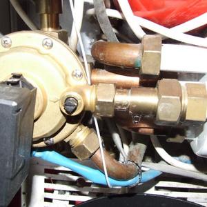

    Worcester Bosch 240
    Ok - I'd appreciate a little more help if possible. I have the O ring and have loosed the left bolt to reveal what looks like an old O ring compressed between metal.. and that seems to be the source of the leak. So. I'm a complete novice here. But I've turned the mains off in the street - but...

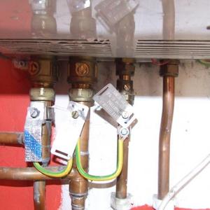

    Worcester Bosch 240
    hi there, thanks for replying. I just posted a picture as an album here - is that how I do it? - with a nice drip coming from the boiler! - the small bolt I think I need to replace is the one to the left of the drip attached to the diverter![/img]

  11. S
    Worcester Bosch 240
    Hi there, A plumber has just fitted a new diverter valve into my 12 year old combi boiler and I now have much quicker hot water and it's immediate now independent of the heating. But I now have a leak with the bolt immediately next to it on the right. This comes out of the diverter at a 3 o...
