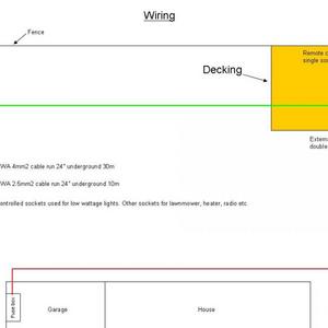

    Outside electrics
    Great thanks very much Ban all shed's....will go with the larger cable. cheers Trevor

    Outside electrics
    Thanks all for replies.... If i use 4mm instead of 2.5mm would this then be ok or would i still need an FCU? thanks Trevor
  9. T
    Outside electrics
    Hi plugwash, the circuit breaker in the CU is 32Amps and protected by an RCD. The CU in the garage is the main one for the house and the remote controlled is from Byron i think. thanks Trevor
  10. T
    Outside electrics
    Hello all, I was looking for some advice on the attached plans i have for some sockets in my garden. The red cable is installed already but was wondering if it was ok to add the green one in now to power some low voltage lights on the other side of the garden or would this be seen as two...
