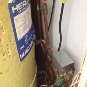

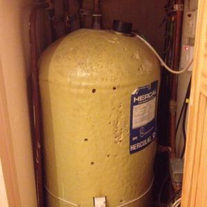

    Yes, was a bit puzzled about that bazdaman, just checked out the cylinder and it is just like the indirect one you pointed out in your link. Port B goes to top of coil, return is at bottom. Can we definitely rule out air lock (because of water coming out of bleed valve)? Can air be shifted...
  5. thebaronn
    Need help with a hot water problem
    Thought as much, hadn't heard of removing a coil! It's pretty snug in there, might have a job without removing the cylinder. See photo. Is it also possible to perform the same procedure at the top of the coil (return to boiler)? If I end up needing a new cylinder, will I also need a new...

  7. thebaronn
    Hi gigz, I'll take a better photo, two mins. Is getting the coil out a relatively easy task? I thought they were sort of part of the cylinder. No worries about the mixup Hugh, I have at least learnt something (B is for Bath, love it) :)
