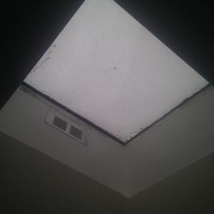

    Condensation on a skylight
    Cheers - by ingos do you mean the wall inside of the kerb? I tried the fan/paper test - it doesn't exactly feel superglued on, but I can't pull the paper away directly, I have to slide it down. It's probably not the best fan ever, but seems adequate. It's one of these btw...
  10. T
    Cheers for the reply pinenot :) We have an extractor in the kitchen, and our tumble dryer is in the garage. I think the only place which could easily contribute to the moisture is the bathroom which is just along the hallway (the door is probably 6' away from the skylight), but we do have an...
    Hi - we have a skylight on our landing and when we moved in 2 years ago, we had the glass repaired - it was single glazed georgian wire, and was replaced with toughened laminated glass of the same thickness (two pieces of glass sandwiching a plastic barrier) - I'm not sure if the old skylight...

    Skylight condensation problem
    Cheers for the advice mate. I'm not sure how easy it will be to get double glazing in there though... the frame only really suits 6mm glass (or 8mm at a push maybe) and the glass would need to be laminated and toughened (it's dead flat so will potentially have snow sitting on it in the winter)...
    Hi, we moved into our new house this year in the summer and one of the first jobs I did was to reglaze a broken skylight. The skylight is a fairly conventional wooden box with a metal frame on top. It doesn't open or have any vents. It originally had one pane of georgian wire glass (and...
