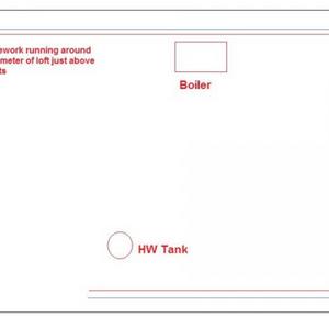

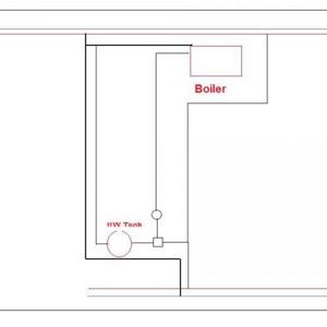

    Radiators Heating up when only Water Heating is selected
    I have tried to create a pipe layout just showing the main structure without showing where the radiators are. The vertical pipes one of which is illustrated as bold are running between the joists and about 50-75 mm lower than the red and blue 22mm flow and return to the radiators which...
    I believe the system is balanced.... However I did it myself after having to rerun some of the pipework in the loft because of a loft conversion. I didn't know about the temperature drop, so it has all been set up by best guess. The Plumber had been told to run the pipework around the...
