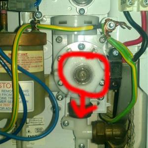

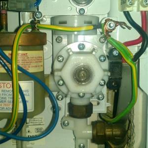

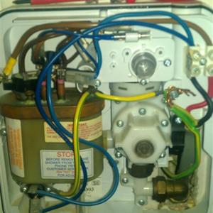

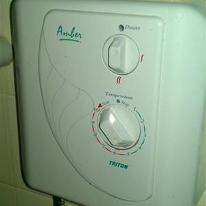

    Leak from Triton Amber Shower
    Thanks for the offer... Will probs take you up on that offer when I get the part later this month. Thanks again! Very helpful!
  2. T
    Thanks for the info. Hope you don't mind me asking some follow ups... * The stabiliser valve I assume is the "tap" part that the water is leaking from? * Where can I find this part online? * Will I need a part number and if so where will I find this? * Finally is there any...
  3. T
    Hi there, I have recently moved into a house that has a Triton Amber electric shower installed. The shower seems OK but has a bit of a leak which is doing my head in, as it has progressively got worse over the last 3 weeks. I have uploaded some photos to show the unit and where the leak...
  4. Leak
    Leak
    Leak is coming from main tap and dripping to bottom of casing then dripping through the casing join.
