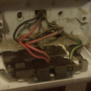

    age of installation
    Thank you all. This is an ex-council house and I have no idea if the CU was istalled the same time as conductors. The earth arrangement is TN-S. There are 2x32A, 1x16A, 2x6A MCBs all type 1 and 30mA RCD – I think. I am going to get an electrician to test it. However, I wonder if I can get away...
  5. T
    age of installation
    Hallo, Can anyone tell me how old this installation is and do I need a complite rewire or just new sockets and CU ? Thanks
