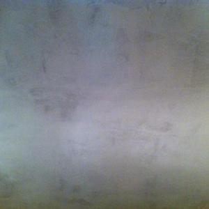

    HELP PLS! - Mist not sinking in
    Thank you all for the advice I have now ordered 5l's of Zinsser Gard. I managed Elvis a long time ago and the money ran out then too so I now have to do all my DIY myself! The only thing I haven't done yet is brick laying but I'll leave the extension to a brickie and I'll do the garden...
  14. T
    Hi - the paint is Dulux Brilliant White Matt emulsion and was very thick and gloopy, it just blobbed out and didn't pour. The over trowling is just what I have read on line. I plastered it myself and didn't polish it much at all. It was the second time I have plastered but did a very good...
  15. T
    Hi - the paint was very thick and I used about 60% water and 40% paint. It didn't run down the walls when I rollered it on and was about the consistency of thick hot chocolate. Are you able to scrape a mist coat off a wall?
