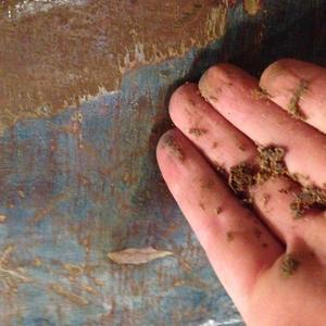

    Is it limewash painted on my walls...
    Thanks for the advice. I've just quickly searched and is 'sandtex stabilising solution' suitable? I've removed the majority of the flaking brittle stuff but this last part - wall along side the stairs is killing me to remove. Once it's had a coat of the stabilising solution will it be ok for...
  8. T
    Thanks for the info. I googled distemper and it looks familiar to what's covered on every single wall in my house (under the woodchip wallpaper that is). I've also found that spraying with water helps ease the more stuck on parts. I'm wanting to skim over the 'good' walls - did you plaster over...
  9. T
    My 1900 mid terraced house was stick in the 1960s when I bought it. The walls are layered in this horrendous stuff, not paint but is on top of the old plaster. It's mainly pale blue but is brown or green in places. It's brittle when scraped but in places is very difficult to remove. When sprayed...
