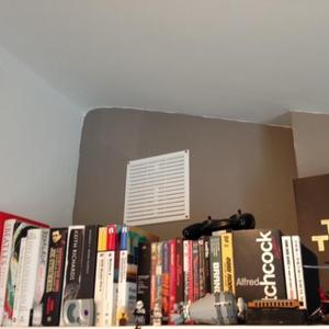

    I ran a de-humidifier in there for a bit which seemed to collect quite a bit of moisture but didnt really help the walls. THere are three airbricks in there whcih the builder installed about 1 month ago.

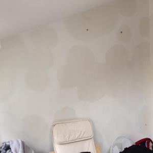

    Hi all I have a problem with an outside office that was newly built in Feb this year. When we have cold weather 'cold damp' spots appear on the plaster with salt coming through as well. I have reseacrhed this until I am blue in the face and can not find a fix. My builder has been round to...

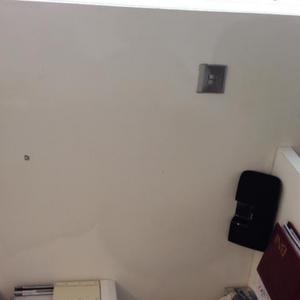

  11. damp cold spots
    damp cold spots
    a set of pics of my damp spot cold spot problem in my office
