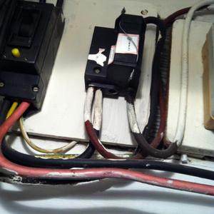

    Is this what we're talking about next to the VOELCB? Heres a close up of consumer unit and spaghetti 'prince phillip' wiring :oops:

    How would I be able to tell? My electrics are very weak indeed, are we looking at where the wires run into the bottom of the black switch?

    securespark, many thanks for your reply, it is indeed the pictured circuit breaker :cry: I tried taking individual fuses out to rule out a circuit when it was happening last year and it still tripped out whichever fuse was removed Heres some pics of the dreaded wiring!
