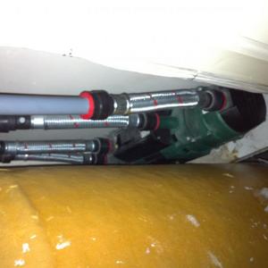

    We have a THD 95de shower pump, must be at least 12 years old, suddenly made a double thump noise and it died. Tried changing the fuse but still nothing. Is there anything I can try or does it sound like we need a new one?
