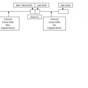

    It is a second hand unit and it was previously connected with via 6mm2 T&E into line 1. Wish I had just ran in the 32A supply :evil: I've asked the owner to send my a picture of the circuit diagram on the lid of the control box so I can have another look at whats connect to the control...

    Sorry, forgot to mention that if the last option was used then a jumper needed to be moved on the PCB in the control box. As there was only 1 option to install with a RCD, then I went for that. The hot tub is Canadian so I thought the first two options were for countries where perhaps RCD...

    Adam, there was no rating on the hot tub instructions, though the installation instructions option were either; 1 x 32A feed into line 1 with internal link to line 2, 2 x 16A feed into each line, 1 x 16A RCD protected feed into line 1 with internal link to line 2. Theres a heater rated...

    Hi guys, I’m after some advice. I have just run a supply for a hot tub for a family friend as follows: Everything tested ok and the hot tub powered up fine when I was there although I didn’t run it for any period as there was no water in there. The following day the owner was running...
