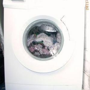

    Hotpoint Aquerius 1100 WM63 drum bearing
    Remember me? 10 months on and she's gone again - this time terminally. I don't think my last replacement seal was tight enough & let water in. That or my part was of cheaper quality. Anyway, true to my word, I've saved my time and put the money toward a new (£219) Zanussi...
    It's fairly straight forward IF you've done it before - I hadn't! With a bit of help from Tinternet, it took me 12 hours including head scratching, sourcing of parts / tools and occasional spanner holding moments by partner. I could probably do it in six next time knowing what I am about to...
