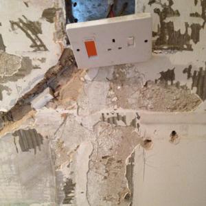

  3. Cooker switch
    Cooker switch
    Thankyou for your help <br>Here is the cooker switch. We need to drop this down the wall another 2 ft. The cable goes up the wall so we can not access to run new cable<br>Look forward to your reply<br>

  5. T
    Cooker Cable 45 amp
    Hello We are moving our Cooker around 1 meter from its current position. We need to extend the cable and then plaster over the top so where we have extended cannot be seen ( plaster then tile over ) Could some one tell us how we can achieve this ... Can we do this ? Junction box ? That we can...
