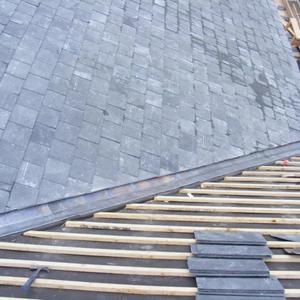

    Open valley - slate and a half?
    were not going to agree LOL neat roofing by the way,.......... but.......... it is spec by all manufacturers to use slate & halfs for valleys, i know this you should have a read up coz although your roofs are neat they are wrong technically PS Im not a DIYer you wouldnt get a guarantee from...

  9. T
    so slate and halfs are useless then cos they didnt use them on verges in the old days? Simple as this and take my word for it any cut less than 150mm you must use a slate and a half to achieve the best fixing/bond, but if thats too technical to do without messing up your bonds just put silly...

  12. T
    You should always use a slate & half where needed you will get a better fix and bond than using smaller cuts, as once the scaffold is down you dont really want to be going back on the roof for repairs. Trust me its worth spending the extra
