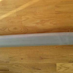

    Boiler flue failure
    Hello all, I received a very courteous reply from Heateam's Customer Relations (no need to give the person's name). The reply had three main points, I believe: 1) They are aware of 'a very small number of similar failures of this component'. 2) They were willing to provide a replacement...

    Boiler flue failure
    Thanks everyone for the replies. Gasescape, what was the approximate age of the installation you saw this on? I wonder if there's been a bad batch of flue tubing from somewhere a few years back? I'd bet that Potterton and others source from the same manufacturers. Quick update: My...

    Boiler flue failure
    Hello All, I had a Potterton ProMax 24HE combi boiler installed about 6 years ago which recently developed a fault. An engineer visited and diagnosed that, among other things, the flue had failed - he thought probably the seals between the different sections of the concentric flue had failed...
