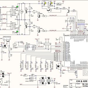

    Glow Worm (Valliant) UltraCom 30cxi schematic
    Tony, I'm surprised you are not pleased at having been promoted to your now elevated position of 'Monkey's Trollop Sack'! ;)
  2. underwurlde
    \S/ Send me a (some?) PCBs to reverse engineer then? PM me...
  3. underwurlde
    Maybe I could do a 'how to' thread based on one of those PCBs while I was at it.
  4. underwurlde
    If I had one to hand, sure! ;)
  5. underwurlde
    PM me your email. ;) Will try my best to help, but fault finding is an art!
