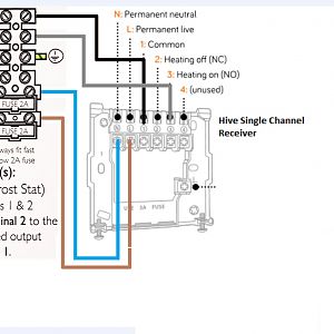

    Hive receiver installation
    I have a hive heating only thermostat that I was going to install. Currently I have a honeywell thermostat attached to the Baxi combi boiler. I have checked the wiring to the boiler and think I know how the hive should be wired but wouldn't mind a bit of clarification from any experts please...
