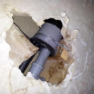

    Leak in living room
    Cheers, thats what my friend thought they where only for pipes going down vertical. He also said something about there being no bend even, so its like a straight pipe to the outside so as the pressure builds it runs back and forces the rubber seal off. I had a look at other houses near mine...

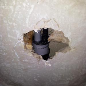

    Anyone seen this before not sure if I can complain about the way it was fitted? Cheers Vinty

    Leak in living room
    Hi everyone first post on here just looking some advice :) Been living in my new house 2 years this month, a few months back there was a leak in the living room ceiling. Builder came out and said it was the shower seals and resealed the shower. I then got the ceiling fixed and a few days...
