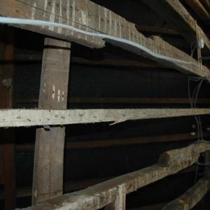

  11. W
    First floor ceiling sagging in a Victorian house
    Hi All, I am hoping for some advice. I am in the middle of renovating a Victorian terraced house and decided to remove the first floor ceilings as I thought the lath and plaster ceiling was sagging badly. Once I had removed the lath and plaster (nice job - NOT!) it became clear that it...

  15. Victorian roof design.
    Pictures of roof structure.
