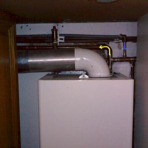

    We've been powerflushed - but can you plse answer this?
    yellow arrow shows pipe to open vent and the blue, the feed and expansion. The pipework goes round to the right and under the floor to the pump and then splits into two for the water and heating.

  4. WillsNana
    No those pipes sit above the boiler. They were renewed in 2004 and I have checked them with a magnet but they seem ok ( see My Images, Pump Album> Boiler)
