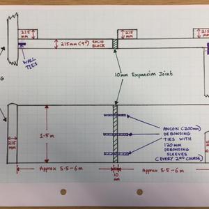

    Thanks again for the information. Would it also be an option to use a trench fill foundation shuttered above ground level or alternatively use high density blocks below ground level up to 150mm or install a DPC above ground level?

    That's great, thank you 👍 I might double up the first few courses (430mm) then once within 1300mm just one coarse (215mm). Or alternatively just put in extra piers as suggested at 2m intervals. Thanks

    Thank you for the detailed information, so just to clarify you would recommend just standard ties or wall starters at the ends. So shouldn't need the debonding ties on the ends just the middle. Also is it okay to tie in the pillars with wall ties as opposed to overlapping the blocks? This...

    Does this design look okay? Would you also recommend using the debonding ties and an expansion joint when I tie the wall in to the two existing walls. Or shoul;d I just tie the walls in with standard ties? Thanks

    Hello, If I put the 10mm expansion gap between the two pillars in the middle of the wall (approx 6 m either side to corners), should I just leave a 10mm gap and build up corners on each section (4 corners). Or do I need to install foam in the gap or Helical expansion joint stainless steel...

    Thanks Tony for the information, the wall will be blocks on the flat, so 215mm wide. Sorry if it wasn't clear. Does this sound okay?
