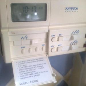

    Hi Dave Thanks for understanding my 'learning'! LOL Just another couple of things: If I dont ever set the DHW to come 'on' on the programmer, it should never heat the hot water right? If right, then if i get hot water without ever setting it to come on, I have a problem? Possibly...

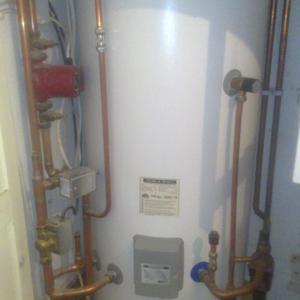

    thanks, ill check that. Could you explain about why i have a boiler and a heating tank? cheers

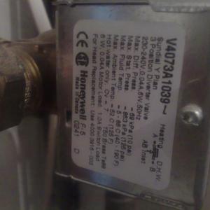

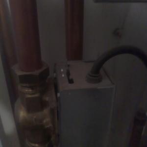

    Hi Dave Yes you are right, its new to me. Not a new build. A sticking 3 port valve will mean that the DHW and CH run together?

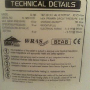

    Hi All. I have just moved in to a new house, and am a little confused as to how the system I have works exactly and how I can adjust it. SYSTEM: Boiler Potterton Suprima 50 CL145 Water tank Room stat Programmable potterton control model EP2002 There is a small (5 Gallonish?) tank in...
