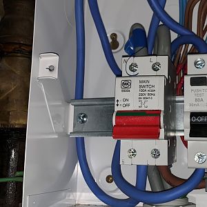

    Hi In my (new) consumer unit, there are 3V across the Neutral bar and the earth bar, when the mains is off. There is also 53V across the mains switch from L to N when it's off and 44V between the line supply and line out. Is this normal when the mains switch is off? Isn't N and Earth connected...
