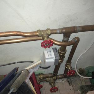

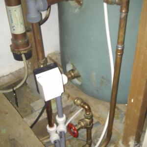

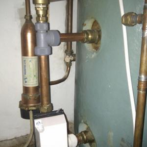

    Problems with my S plan Heating system - Microbore pipes etc
    It is a vented system and I do have a feed an expansion. My cold feed is in the attic up at the header tank. My vent goes up through the airing cupboard (the straight pipe with the little stop end in it) It vents up to the header tank. The other pipe with a stop end in it in the picture...
    Hi there. Some images can be seen at http://picasaweb.google.com/yellowmitch/Heating?pli=1&gsessionid=VgSM5YMcaGZdTzHqeKqDSg# I am trying to upload more. John, what is f&e? (full and empty?)
