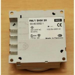

    Hadn't thought of that, thanks. Would I need any additional wiring though? I suppose the 42 should be easier if it's a straight replacement.

    Thanks for that, this helps a lot. The Grasslin Digi 42 looks like it supports NO on pin 4 and NC on pin 5. Looks promising but more expensive. :roll: http://old.lscontrol.dk/LS_pdf/fm1digi42oi.pdf

    Yes, 100% sure. Is that bad from a compatibility point of view? :?

    Thanks ade2k, when you say wire it up the same, do you mean to wire up the new one on pin 4 since there isn't a pin 5?

    Hi, new here although have lurked for several years so I owe you all a thank you for helping me in the past. I recently had a Heatline Monza 24 boiler fitted which so far has been excellent however I'm feeling the limitations with the mechanical dip-switch timer and would like to replace it...
