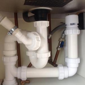

  7. W
    Gurgling sink problem....advice needed please.
    Hi guys,I'm back again.....I have now fitted the air vent BUT sadly the gurgling is still happening see pic for how I have attached the vent .... ...hopefully I have done it as suggested,I also noticed there is no noise or vibrating from the vent when I have heard the gurgling sounds,I...
  8. With air vent
    With air vent
    Air vent fitted
  9. W
    Yep,I got the McAlpine one cheers, just sat now taking a few deep breaths before commencement of " Operation Sink Pipe " begins. 👍. 😁
    Hi again guys,just been idling the time away reading up on vent valves and noticed these two descriptions..........McAlpine Air Admittance Valve Ventapipe 25 1.5" VP2W Durgo type.......And ............McAlpine Air Admittance Valve Ventapipe 25 1.5" VP2W ( without the Durgo bit on the end...
    Hi guys,ok one final question......I now have all the bits of pipe work and the vent valve,my question is can I put Tee connection anywhere on the down pipe as long as the vent is connected as high above the water trap as I can get it ?.....I only ask as the bulk of sink draining pipes are...
    Ah Madrab.....now I think I see what I should do....thank you for that explanation....so I have to get. ...a T connection ( fit that into vertical pipe )........an elbow to fit into outlet on T connection.....then a small bit of pipe inserted vertical into elbow.....then the Valve inserted into...
    Hi guys,thanks....I cannot place it horizontally onto the run in pipe as it is behind fitted cupboards and I cannot access it,so if possible could someone point me in the right direction to get the parts I need please,I want to put the vent on the vertical pipe as that's so much easier to...
