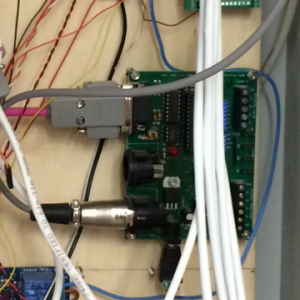

    My home automation
    I use this module for the DMX control It's a Velleman DMX controller. I got it from Maplin maybe 8 years ago. It takes RS232 in and spits out DMX, you send a pair of values (hex encoded I think) out of the serial port and the module sends it over the DMX circuit. I'll see if I can find...

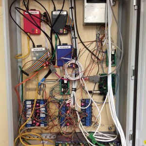

    My home automation
    Hi Bob, yep those 4 raspberry pis drive everything, they do dmx for the lights and you'll notice a couple of external rs232 for serial comms, all the relays and inputs are via pokeys 56e and I use i2c for temperature sensing
