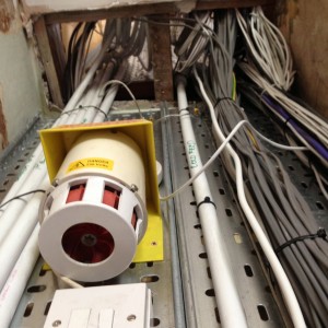

    My home automation
    Hi, You can't see the back door, but it has a couple of big mains fans in it, that slot in the floor is where the air comes in, and it's sucked through and out the back fans. Works pretty well, but in all honesty I tend to keep the doors open now, you can't hear the fan noise from the main house

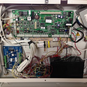

  2. R
    My home automation
    Here's how I interfaced to the Galaxy GD96, in the middle you'll notice an RS232 <-> RS485 converter which I've connected across the data line of the alarm. It's fairly easy to read the data off this serial link and use it to do useful stuff without the need for separate sensors for alarm and...

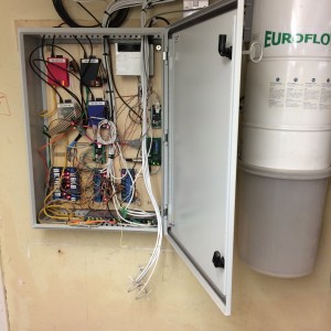

  4. R
    My home automation

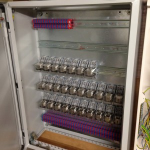

    Relay cabinet 1 build in progress

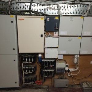

  15. R
    My home automation

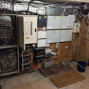

    I'll get some pics of the other cabinets, there are 3, two are homemade. Thanks for the comments!
  16. R
    My home automation
    Hi all, My second attempt at home automation, we recently moved to a bigger place and I've redone the automation, keeping the bits that worked well in the old house. It's a work in progress, but thought it might be of interest.
