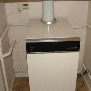

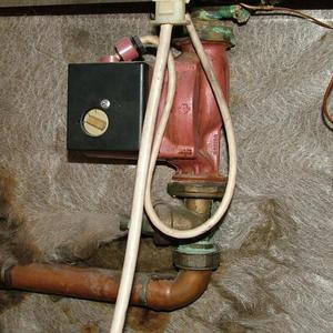

    upstairs radiators get warm when the hot water is one.
    Checking this evening - both sets of pipes are hot , though the CH is not on. The hot water is. The pump only has valve at the bottom to isolate the pump. I have the original Trianco TR90 product manual but it doesn't show the heat exchanger in detail and the back of the boiler is...

  6. C
    yes , If I remember right - which is why I thought they were there to isolate the pump.
  7. C
    yes , just above the pump is a manual valve , like a tap. I assume it's there to isolate the pump if it needs replaced.
  8. C
    Hi , thanks for a quick answer. Yes , hot water is gravity fed. But hot water heating is a totally separate circuit. The only place the two circuits come close is in the boiler at the heat exchanger. ???
  9. C
    I have an old oil-fired Trianco boiler. Separate circuits for CH and HW , no diverter valves anywhere. Boiler downstairs in kitchen. Hot water tank upstairs in airing cupboard. Towel radiator in bathroom is part of the hot water heating circuit. Since last year , radiator on landing now gets...
