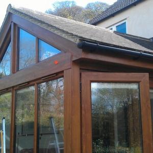

    DGU looks fine - resting in a uPVC trough with weep holes that work. Very heavy rain over the last few days, but only a small leak. Looking back at weather data - there is a correlation between NW winds and more significant leaking - we are on an exposed site, typical winds here from from...

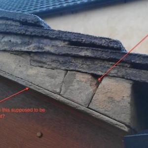

    Right - got the soffit off. Thanks to a thread on this forum, used a chisel to remove the poly top off the poly top nails. Then a wire cutter to lift out the heads a little more, then mole grips to pull them out (have a nail bar as well, but only cheap version that wouldn't get under the...

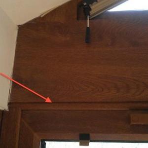

    The trim is under the plaster by about 5mm each end (3m long). Does appear to be glued on (I can stick a knife in from the underside and feel resistance in various places - uneven and what appears to be clear silicone/glue bits comes out). Thin silicone bead on top edge (I presume to stop...

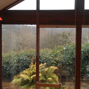

    Hi, Our back room is leaking again from the horizontal cladding between lower rectangular glazing and upper glazing at the gable end. Externally it appears built using all uPVC with a tiled roof. Docs suggest a steel frame was used (there is one glazed end, one part glazed and one solid...
