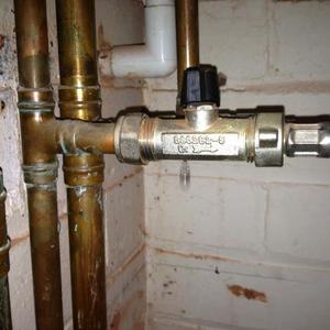

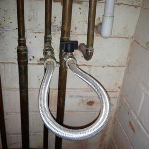

    New filling loop opposite way round to the old one. Or is it
    I bought a new flexible filling loop to replace the old one, as per this thread: http://www.diynot.com/forums/plumbing/leaking-filling-loop-and-two-of-them.361230/ Just looked at the new one and it's the opposite way round to the old one, by which I mean: Old one, DVC on cold mains...

    Leaking Filling Loop, and two of them
    Thanks. Actually I don't suppose I have to replace the whole thing do I? Just the isolator valve (?). The one with the black knob on the back. The double check valve is on the left and actual flex pipe is fine. Just that the less compression joints I have to re-make the less chance of failure...

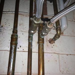

    It's difficult to say how much I've actually been filling it up due to leaks (which I've not noticed, by the way). I've done a bit of my own CH work in this house. So over the past 2 or 3 years I'm usually at a point where a new rad or towel rail has been fitted. Or the system drained and...
    Thanks for swift reply. Yes, replacing the external filling loop. Presumably it should have some sort of non return valve built in to comply with regs. Just reading the Installers Instructions again the 'built in' filling loop is meant to be 'detached' after filling. Which makes the...

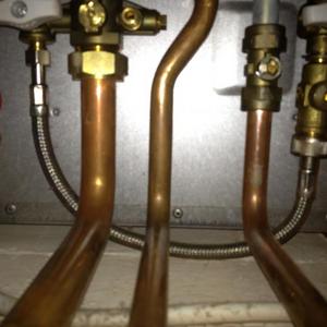

    Boiler is a Vaillant Eco Tec Plus 831 Combi. Fitted about 5 years ago. Serviced by Vaillant, last time last June. There's a filling loop which I use, and was shown how to use by the installer. Here's a few pictures: I'm only having to top the boiler up every few months. The...

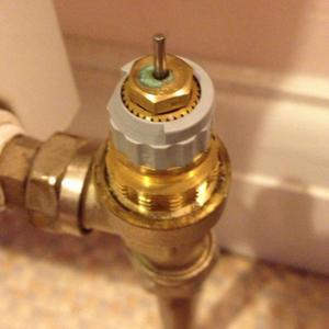

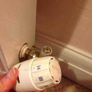

    Danfoss Randall TRV. Will it leak now?
    Heating up fine now. Doesn't seem to be any leak from around the pin, presumably there's some sort of O ring sealing it. I'll leave it as is for now. I just gave it lots of pushing in/letting go. Is WD40 recommended?
    I had a stuck TRV (rad cold). Found some instructions, got the plastic shroud off. Pushed the little pin in and out a bit. Thought I'd give it a thorough waggle with pliers. The pin came right out. Then a bit of a leak through the hole it left. Put the pin back in. Doesn't seem to leak now...
