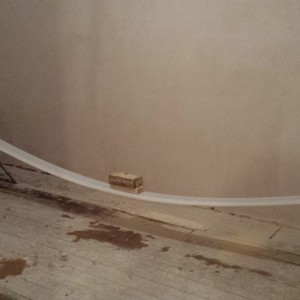

    Hello All, Heres a quick update..... after leaving the brick on the skirting board over night, the result this evening was a slight bend. As soon as i lifted the brick the board pretty much bounced back, not exactly straight again but near enough. I suspect this happened because i hadnt soaked...

    here the pic didnt attach the first time20160321_195714 by Vim posted 21 Mar 2016 at 9:07 PM

    Hi Jobandknock and ladylola, Thank you for your reply its a real help here. ive taken the plunge and started the process, I'll update on here as i go along. Ive sprayed the skirting board with water, i should have completely soaked it but only just saw your reply. Will leave it over night to...

    step 1 - bending MDF skirting board
