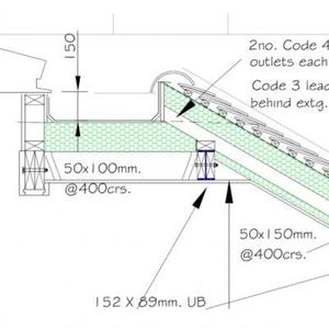

    Whole host of pitched to flat roof questions
    I'm sure you're trying to help despite the insults. My architect has suggested and designed for lead lined outlets through the parapet, level with the box gutter as in his drawing in my first post. we have the same sort of arrangement on a larger area of flat roof which can just about seen on a...

    Thanks for your input but to be fair the design was always going to be a compromise as the upper floor windows are quite low and I didn't want them too obscured with the new lantern on the roof. That's why the flat roof has been set below the level the ridge of the pitched roof section. Not...

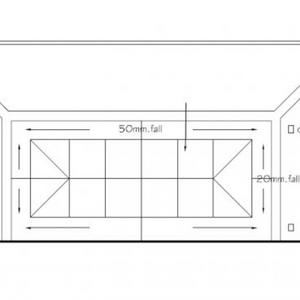

    Thanks once again Oldun, any reason I couldn't use plastic gutters and mount the brackets on the front of the tails? Mono tiles it is then. Re the lead outlets, just been having a look online, any experience of flat roof drainage outlets...

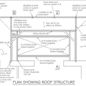

    Thanks for your comments Olden, all taken on board. I didn't post that diagram first as I had a rough idea the structure was ok and my questions referred to the roof covering and insulation. Celotex calculator checked and on the left hand heading under construction it says TB4000 but looking...

    Hi thanks for the replies I think. Oldun, not sure what you mean about a skyhook but that upper beam is really the other side of a cranked steel beam which roughly on that drawing goes from where it says 50X100mm then down to a steel post in line with the rafters. To the left of the 50x100mm it...

    Hi I’m in the process of building an orangery on the back of our house which will have an outer pitched roof with a flat top which will then have a glass lantern on top. I’m hoping someone will be able to point me in the right direction and answer a few questions about the roof makeup...
