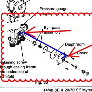

    Diverter valve issue
    I would still replace the diaphragm, for the cost of £10 or so. The diaphragm can become stretched, still looks ok but doesn't function as normal.

    AAV
    Hi guys, I work for a local council and change a vokera mynute AAV at least once a month, for what its worth, I find the easiest way to change it is by removing the pump head, this allows access to the AAV with pump pliers, very rare to leak at pump and no disruption to gas valve.
